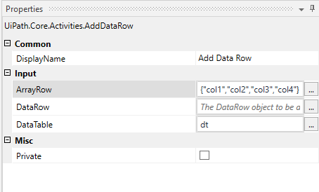

If possible can I have a view on the build datatable activity wizard that displays is the column name and Datatype

i did this
could you sare a screenshot of how your datatable is build?
That is how you assign the value to the datatable
if in_MasterRow(“rollno”).ToString is a number (even when you cast it to string excel will think 123 is a number) you should do it a bit diverent if you want it to look like as string in excel
{in_sub, “'” + in_MasterRow(“rollno”).ToString, in_marks, in_grade}
What I was wondering is how your datatable looked like, to make sure the datatable columns have the datatype I am expecting them to have.
something like this
im getting same error
