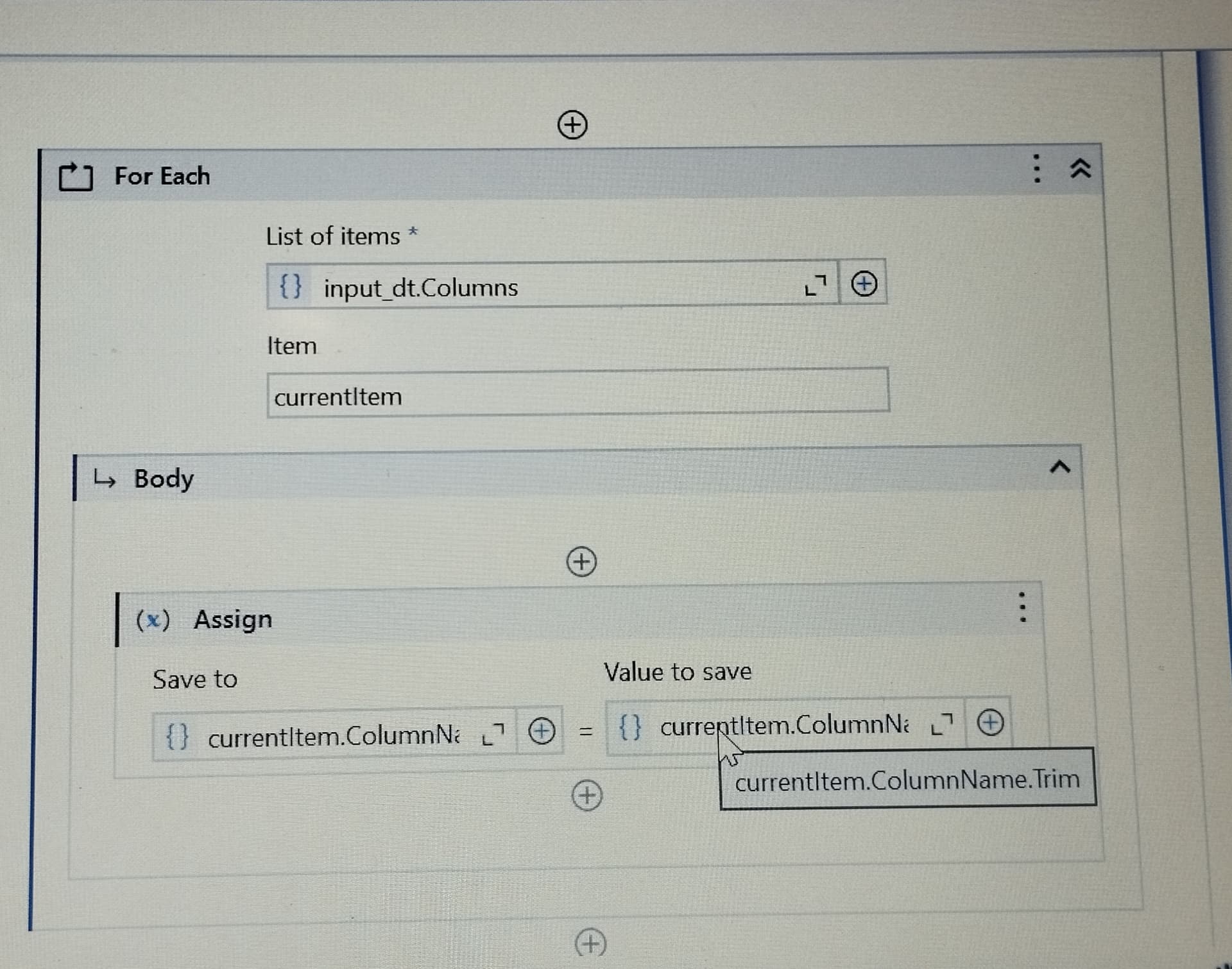

when there is a risk that it can happen just do some cleansing
For each Activity | item in YourDataTableVar.Clone.Columns | TypeArgument: DataColumn
Assign Activity: YourDataTableVar.Columns(item.ColumnName).ColumnName
= YourDataTableVar.Columns(item.ColumnName).ColumnName.Trim()

Hi @kasey.betts
Without query you can try with activity for each
For each -condition = datatable. Columns
Inside loop -body
Take assign activity
LHS
currentitem.Columname
RHS
currentitem.Columname.trim
It will remove all the columns if it os having the spaces
Hi @kasey.betts
For the reference you can see attached screenshots
Cheers…
