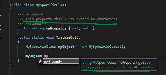

One idea I had was to use XML tags ( Recommended XML documentation tags - C# reference | Microsoft Learn) to remind those who uses these classes that certain properties have to adhere to a certain structure.
Let’s say I have a property that should only be of a string length less than 50 characters.
    public class MySpecificClass
        /// <summary>
        /// This property should not exceed 50 characters
        /// </summary>
        public string myProperty { get; set; }
This tells the IDE to display the summary text when trying to do display that information with that property:

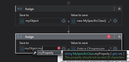

However this information is lost when using Assigns in regular workflows.
Anyone have any experience with this?
Is it because the language for the project has been set to VB.net?

If you use c# project, it will appear.

Can confirm this works when the project is in C#

No, that should work as well:
Here’s my Library, with just one Coded Source File:
And here’s my C# process:

In the latest Studio version libraries do publish the code comments with the .dll files it generates, so they are available for other projects. This behaviour doesnt work in 23.10 so must have been added inbetween, which is nice.
VB projects still do not display the code comments in the coded source file is in the same project.
So looks like one open issue there.
