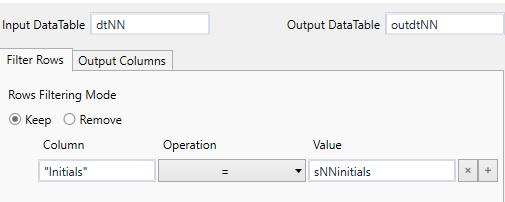

then put filter wizard, so that it should match the initials first and then look for other condition.
“Initials” is the column of CRM.
sNNinitials is scrapped variable.
so i want to convert the column value to be in uppercase always, so that it should match.

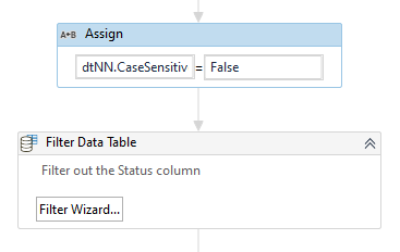

Have you tested to turn off the CaseSensitive option before the filter activity?
dtNN.CaseSensitive = False
no, where i will find this in property panel?
Just use an Assign activity:
aah, ok. let me run now

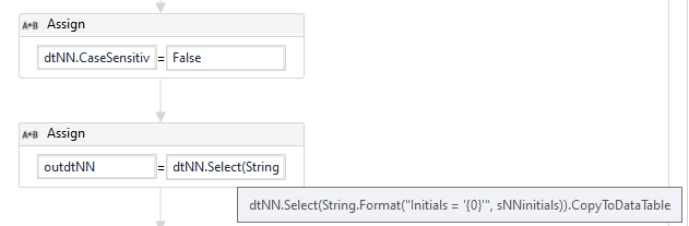

Just tested on my computer. The Filter Data Table activity doesn’t seem to care about the CaseSensitive option. So you will have to use DataTable.Select() to filter instead.
outdtNN = dtNN.Select(String.Format("Initials = '{0}'", sNNinitials)).CopyToDataTable
yes, it passed that condition,
let me try with this condition.
not working that condition.
What is not working? I have tested on my computer and it’s working fine.

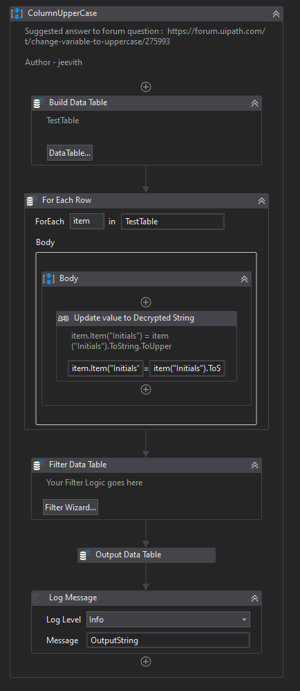

Hi @Rakesh_Tiwari,
Adding to the cool answers from @ptrobot!
You can do it in an alternative way:
In the For Each Row you can use a for loop and reset values to item.Item("Initials") = item("Initials").ToString.ToUpper
ColumnUpperCase.xaml (10.2 KB)
yes, that’s working fine
Thank you so much.

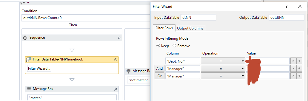

the situation is like i have some condition, which i have mentioned in filterDT, but the problem is, it is matching for some initials and for some it is not matching even the data is correct in Data table.
this sequence has written right after that solution provided by you.
let me know if you required more information.
There might be spaces around the string. Have you tested with Trim()?
item.Item("Initials") = item("Initials").ToString.ToUpper.Trim
no, let me check
the yesterday’s post is closed, and i asked i think different query.
please refer my today’s post.
In today’s post you referred to “initials” but in the screenshot provided there’s nothing about “initials”. I can see that you are referring to “Dept. No.” and “Manager”. Can’t you apply the same logic as you did yesterday with @jeevith’s solution, but add Trim? E.g.
item.Item("Manager") = item("Manager").ToString.ToUpper.Trim
tried, but not working for some of the user even if the deptno and manager is same.

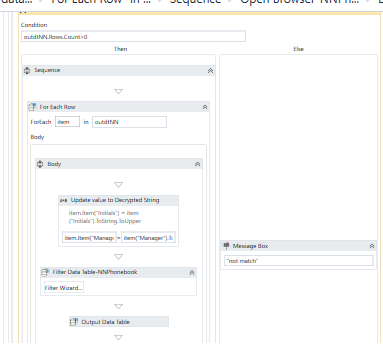

below is the code, let me know if the done something wrong.
Hi! Move out the Filter Data Table activity and the Output Data Table activity outside the For Each Row loop. And also you need three assign in the the for loop:

but my question is why it is matching for most of the user and not matching with few user?
Because you have the Filter activity in the For Each Row loop. You need to convert all the column values to upper case and trim first before the Filter activity. If you do the filter in the loop, some of the values might not have been converted yet and thus doesn’t match.
