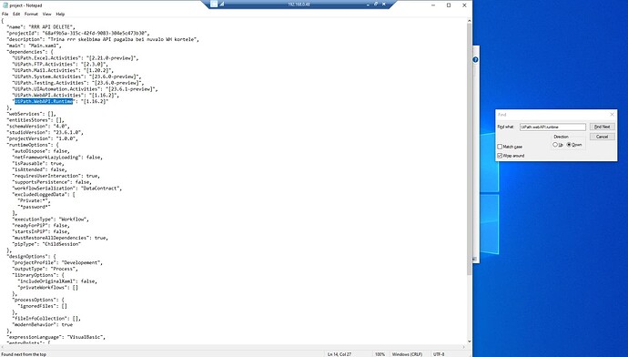

When I view Main.xaml with notepad, i can find 3 rows that have runtime in them, but i cant find anything with “UiPath.webAPI.runtime”

Try to find it in the workflow that you are using WebAPI Activities

Try to verify project.json
Also open details and show here

So basically, i checked Main.xaml with notepad, searched for UiPath.webAPI.runtime but didint find anything. I checked then project.json of the workflow, found only one line with the words “UiPath.webAPI.runtime”.
