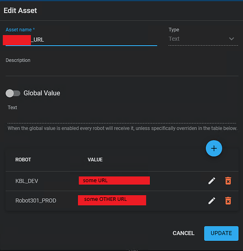

I’m not sure what other people do, or what best practice is, but i can tell you what i do:
In orchestrator I have an asset pr robot that defines what environment that robot is placed in.
Then i use that asset in the workflows, so the workflows know what environment they are running in, and use that to do stuff that is different pr environment.
Example:
Robot 1+2+3 is in production and have “CurrentEnv”-Asset set to PROD
Robot 4 is in test and have “CurrentEnv”-Asset set to TEST
Robot 5+6 is development machines and have “CurrentEnv”-Asset set to DEV (one which is my machine)
When i then run process “download file” that needs to download to my desktop if running on my machine, or to another folder if running in test or production, i then write:
CurrentEnv = Get asset(“CurrentEnv”)
If (CurrentEnv = “DEV”)
Then DownloadFile(“c:\user\xxx\Desktop”)
Else DownloadFile(“networkfolder\robotOutput”)

Well no. When using assets, I’m just using value pr robot:
The example was for your connivance. Sorry if that was unclear
I think i understand your question now.
You want an asset pr environment, instead of an asset pr robot, so you don’t have to type the same asset value for multiple robots in the same environment.
My answer was for a different question. My bad

@DavidMartin When you add specific environment variables as Assets, did you create two different variables for 2 environments with different variables? For eg if I have a variable named ‘ClassId’ with different values in dev and Test environment, do we need to create 2 different variables such as ‘ClassId_DEV’ and ‘ClassId_TEST’ with values as per environment?
Yes, I have taken that approach where the assets need to exist in the same Tenant.
Where possible, I use Dev environment as one Tenant, with Test and Production also having separate Tenants. This allows the same folder names, the same assets, etc. in each of the environments hence each having distinct values.
Since the original post, with the new versions UiPath, it is also possible to have the same asset names in different folders, which is another alternative approach.
