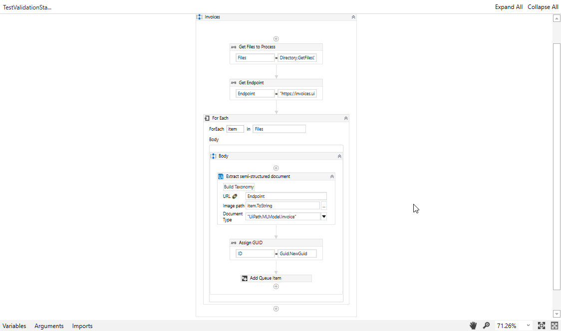

The below will extract invoice information, this particular flow uploads the extracted info into a queue for a human user to then validate via an attended robot
You use it via an api, you upload then receive back the information, you can use community edition.
There is no technical difference between community and enterprise in what you can build etc, the actual difference is the support you receive from UiPath if you pay for enterprise.
