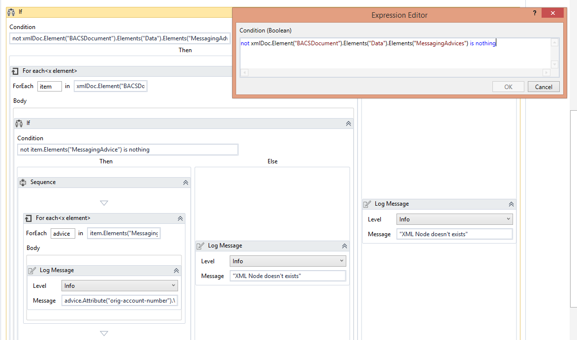

I am hoping for a bit of help. I have built a very simple sequence that reads in the attached XML file. However I am having real difficulties getting out the “orig-account-number” value.
I have attached my simple sequence also for reference. So far the best I can do is return the entire line.
It is also important to note that whilst the sample XML file I have attached has only one ‘MessagingAdvice’ in it, the real file has multiple instances in it.
What I need is to be able to read out the attribute for every line of ‘MessagingAdvice’
You were not looping through the xml nodes. In your workflow, you need to first check is the element exists before accessing it. Then loop through the records to reach the last child node and retrieve the attribute value.
Thankyou for your help on this. I have stepped through your updates and now have an understanding of how it is working along with the test to make sure the element exists
