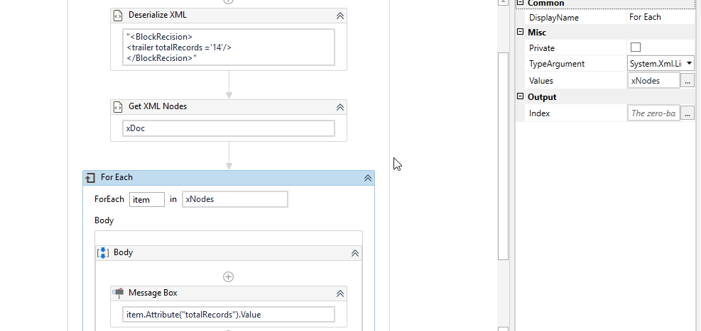

  4. For Each checking if item.Name.LocalName = “trailer”
Unfortunately this only returns a blank value. Any ideas on how to get that 14 out?

    the 14 should be retrieved from Attribute totalRecords, due trailer is a so called empty element

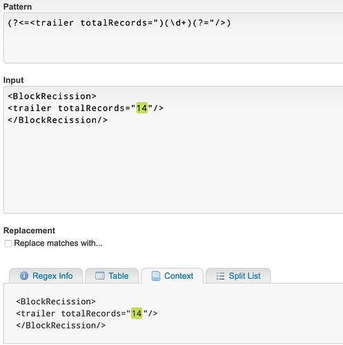

If there is only one occurrence of tag present in your xml file then I recommend to use Regex expression.
Read xml file into a string strXML
resultString = Regex.Match(strXML, strPattern).ToString //parse the string to integer if required

You need to retrieve the attribute value not the element value (sorry for confusing you :slight_smile:).
Check this screenshot and make sure you have changed the item type in for each activity to xelement
