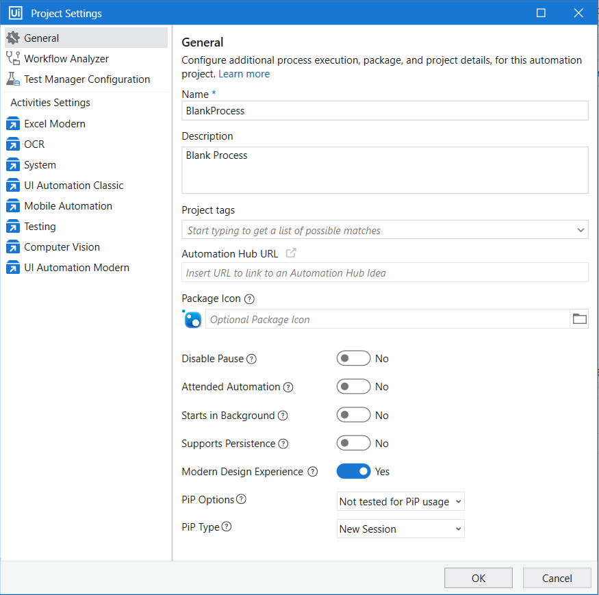

I have a process here that when published is set to unattended, Am I able to change this to attended so I can run it on an automation express license?
The “Execution type” is linked to the “Attended Automation” setting in project settings:
Attended Automation
Set to Yes to indicate that the project should only be executed in an attended context. Use this setting for projects that include UI Automation activities or other activities that require user interaction.
Source: Studio - About Automation Projects - https://docs.uipath.com/
So while you see “Unattended” here, it doesn’t affect the licensing and the process can be run as attended too. If you toggle the “Attended Autiomation” switch on, it would mean that the process should be run only in attended mode.
