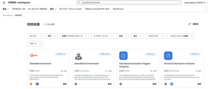

Hello
If you need the old Attended Framework, you should be able to find it by searching for Market Place → Attended Framework in the left menu from the Automation Cloud top screen.

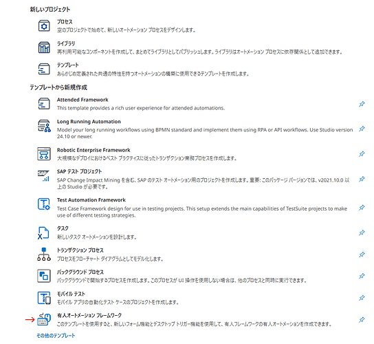

What do you mean by classic and modern in this context?
I believe that in Studio 24.10, the classic design experience has been discontinued, and it seems that activities categorized as classic/modern, such as UiAutomation and Excel activities, are not being used in the framework…
If something newer is needed, the Attended Automation Framework corresponds to the Attended Framework, so I think you should try that.

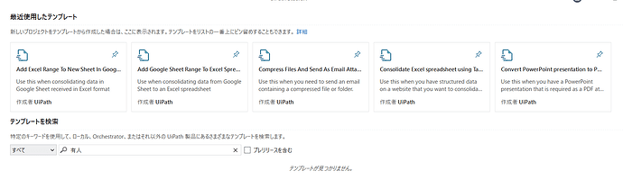

Hello,
I am currently developing using StudioX 2024.10.14 LTS on Win10.
I started StudioX and tried searching for the template “Human Automation Framework,” but it didn’t come up. Is the “Human Automation Framework” or “Attended Framework” not available in StudioX?
It cannot be used in the same way as the RE-Framework.

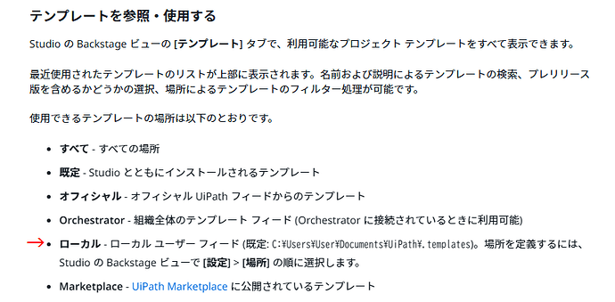

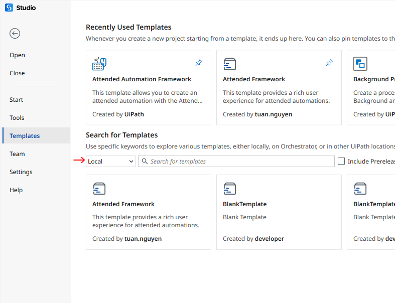

By default,
C:\Users\User\Documents\UiPath\.templates
is where you can place the template’s nupkg file to reference it in Studio under Templates - “Local.”
