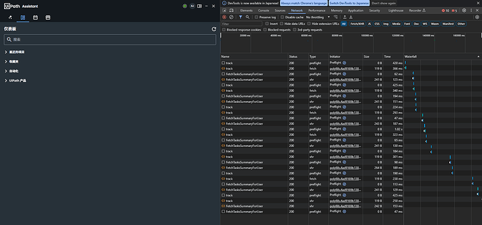

When the Create shortcut is triggered, a GET request to https://cloud.uipath.com/YOUR_ORG_NAME/YOUR_TENANT/orchestrator_/odata/Settings/UiPath.Server.Configuration.OData.GetLicense is called.
Open Assistant in Debug mode → Ctrl+Shift+I → observe if the call is 200

How can I operate the Assistant in Debug mode as mentioned above?
For Assistant >=2025.x.x
A similar Inspect page needs to open
  • If you don’t see yet the right side area, perfor a Ctrl+Shift+I in opened Assistant

Thank you for your response.
Observe if the call is 200
→ YES, 200

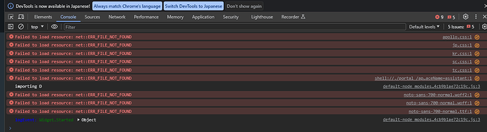

In the Debug in assistant for Console tab, do you see any errors?
What about in the cmd.exe console?
