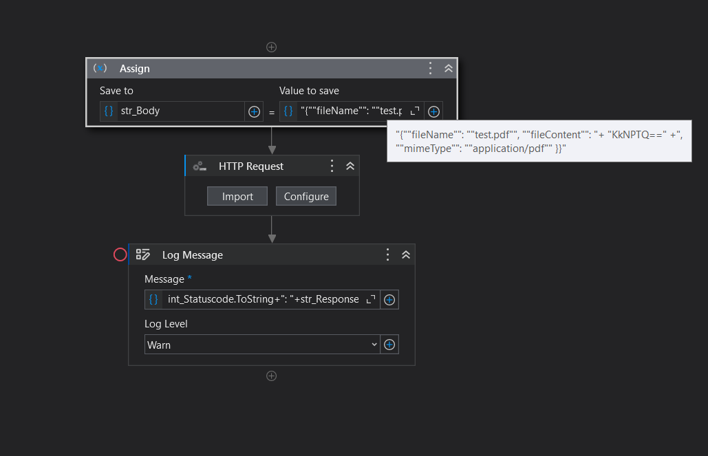

I’m currently working with the HTTP Request activity in UiPath to send a POST request to an API endpoint. The request includes a raw JSON body containing a Base64-encoded PDF file.
Here’s the JSON payload I’m trying to send:
“fileName”: “test.pdf”,
“fileContent”: “JVBERi0xLjUKJb662+4KOCAwIG9iago…base64…==”,
“mimeType”: “application/pdf”
Despite the fileContent being correctly encoded, I’m receiving the following response:
“Errors”: [
“Failed to parse JSON request content.”
“StatusCode”: 400
I’ve ensured that:
  • The Content-Type header is set to application/json
  • The body format is set to Raw
  • The JSON string is properly escaped for VB.NET

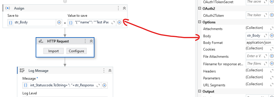

Hello @Muralikrishna_Surve
The Statuscode 400 indicates Bad Request so I think you are right looking at ajusting the content being sent.
I have attached an example of a Post request with a JSON body that you could check for reference.
Download here: API Post.xaml (8.6 KB)
Regards
Soren
I used my Endpoint and run this worflow.
Getting response as:
“Errors”: [
“The ‘useCaseId’ HTTP Header is missing in the request.”,
“The request body is missing.”,
“The ‘api-key’ HTTP Header is missing in the request.”
“StatusCode”: 400
I gave ‘useCaseId’ & ‘api-key’ in Header.
“Errors”: [
“StatusCode”: 400
Just so that I understand correctly - you tried changing the example file I sent into your actual request?
If this is the case, and you get an error message indicating that the body is missing, can you verify that the variable is set?
str_Body =
HTTP Request properties =
I have updated only str_body, Endpoint and added ‘useCaseId’ & ‘api-key’ in Header.
All other properties are as it is
400: {“Errors”:[“Failed to parse JSON request content.”],“StatusCode”:400}

“fileContent” is getting fetched completely in Postman/
But when i use same in UiPath
“fileContent” is not getting fetching completely in UiPath. It is getting truncated.
