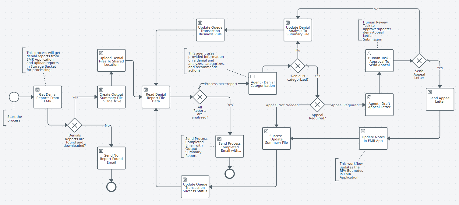

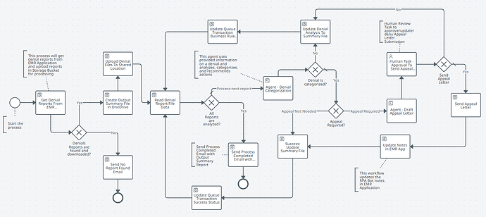

This solution reads and analyzes uploaded denial reports, classifies the type of denial, and drafts appeal letters if applicable. A human reviewer verifies the appeal via UiPath Action Center before the bot sends it to the payer. A detailed summary sheet is maintained for reporting. Technologies used include Agents, Maestro, AI, UiPath RPA, and Action Center.
Steps:
  1. Download Denial Reports from CogniCare EMR (Electronic Medical Record - Application created for Demo recording) Application and upload the Denial Reports to Shared Location OneDrive
  2. Performs Report Data Analysis to identify Denial Code, Denial Reason, is appeal required, Billed Amount, Allowed Amount, Claim Number, Member ID, Payer Information, Healthcare Provider Information, etc.,
  3. Denial Categorization: Classify denials into predefined categories based on denial codes and descriptions. Categories include:
    a) Eligibility Issue
    b) Coding Error
    c) Medical Necessity Denial
    d) Authorization Issue
    e) Missing Documentation
  4. Root Cause Analysis & Suggested Actions
  5. If Appeal is needed, then draft Appeal Letter.
  6. Send Appeal Letter for Human Validation before sending
  7. Report Generation - Summary File
  8. Updated Bot Notes in EMR Application
  9. Send Output Summary Report via email to Business/SMEs
