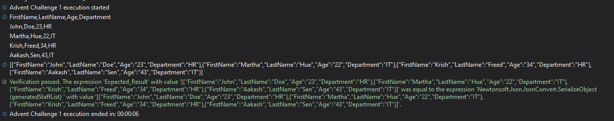

So since the goal I think is to share knowledge and ideas with the community, I will explain some of the design choices I make in this which are missing in some others so far I have seen or include features I don’t think get enough appreciation, such as testing.
I have had the input for this be an argument, not just the FilePath to the input but also the column order. This is to make the project flexible and re-usable so we could handle multiple file locations and multiple column layouts as needed so this can re-order any CSV. There is an argument to also include the csv separator.
After that I am re-arranging by reading the CSV to a datatable (I have that I need the Excel activities for this) and then setting the column position using ‘SetOrdinal’. This sets the column position in a data table. This requires the Invoke Method activity as SetOrdinal is a method of a Column.

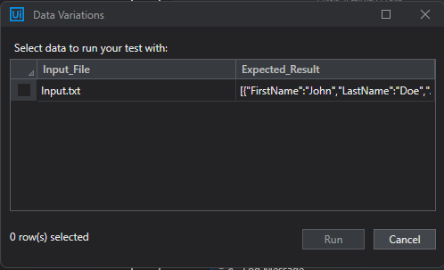

After that I considered Testability so I made a TestCase for the Main.
I added data variations to this test data so I could test with other files should I need to.
I also have an expected result so I can validate the correct output is generated.
I wanted the Test Case to be able to execute without me needing to have a human interact with it so it could for example still work in a build pipeline or test dozens of files at once.
The message box in the requirements prevents this so I mocked the main so that the generated text goes to a log message and a new output argument so the Test can verify it, in this way my tests can run on their own.
Advent Challenge 1.zip (10.6 KB)
