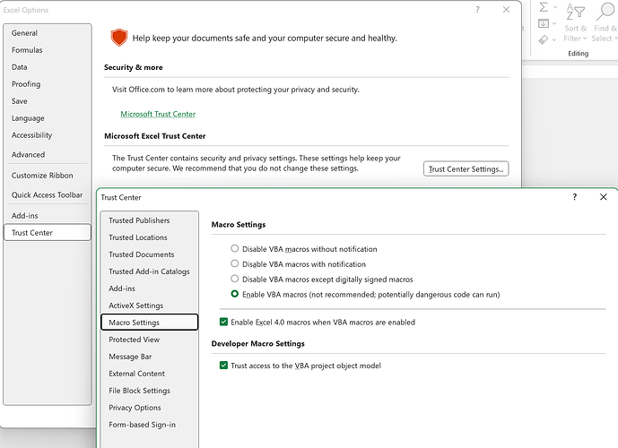

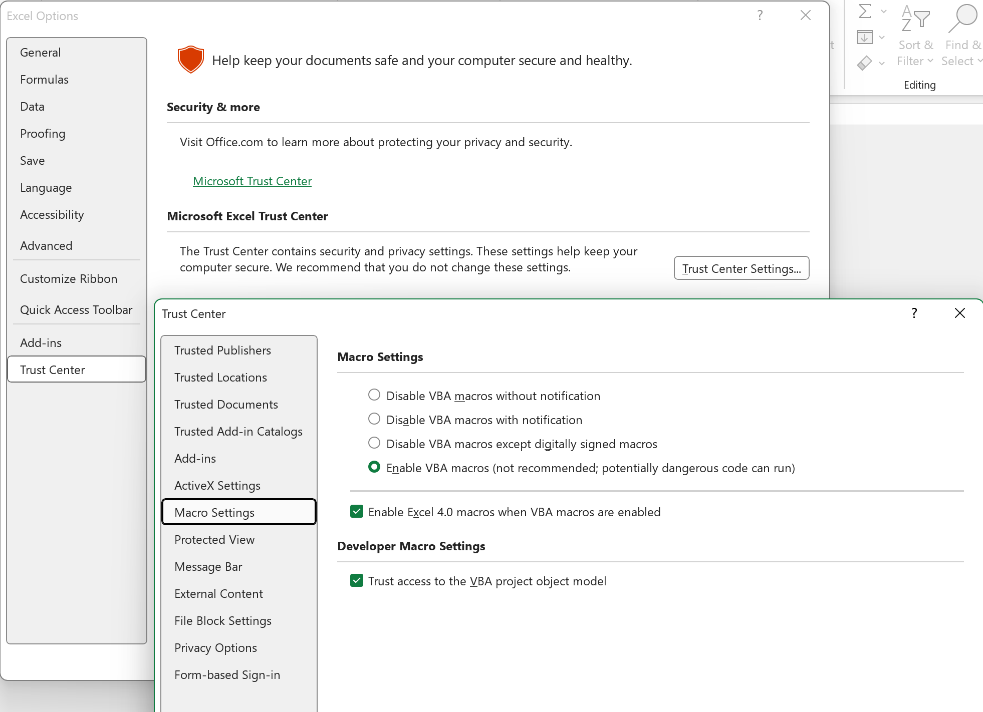

@Kaydo,
For Point 3 use this code. It’s using VBA Code so make sure your change excel settings as below.
Code:
VBA Code: Make sure you change the sheet name as per your requirement in VBA Code.txt file

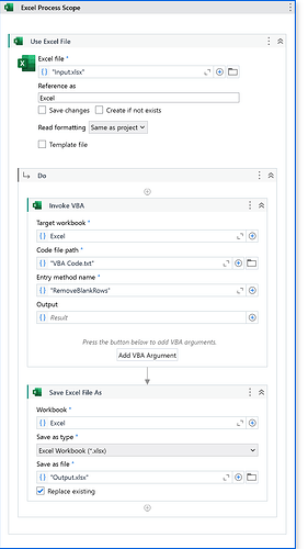

Sub RemoveBlankRows()
    Dim Rng As Range
    Dim i As Long
    Set Rng = Thisworkbook.Sheets("Sept 11").UsedRange
    For i = Rng.Rows.Count To 1 Step -1
        If Application.WorksheetFunction.CountA(Rng.Rows(i)) = 0 Then
            Rng.Rows(i).EntireRow.Delete
        End If
    Next i
End Sub
RemoveBlankRows.zip (70.0 KB)
Thanks,
Ashok :slight_smile:
