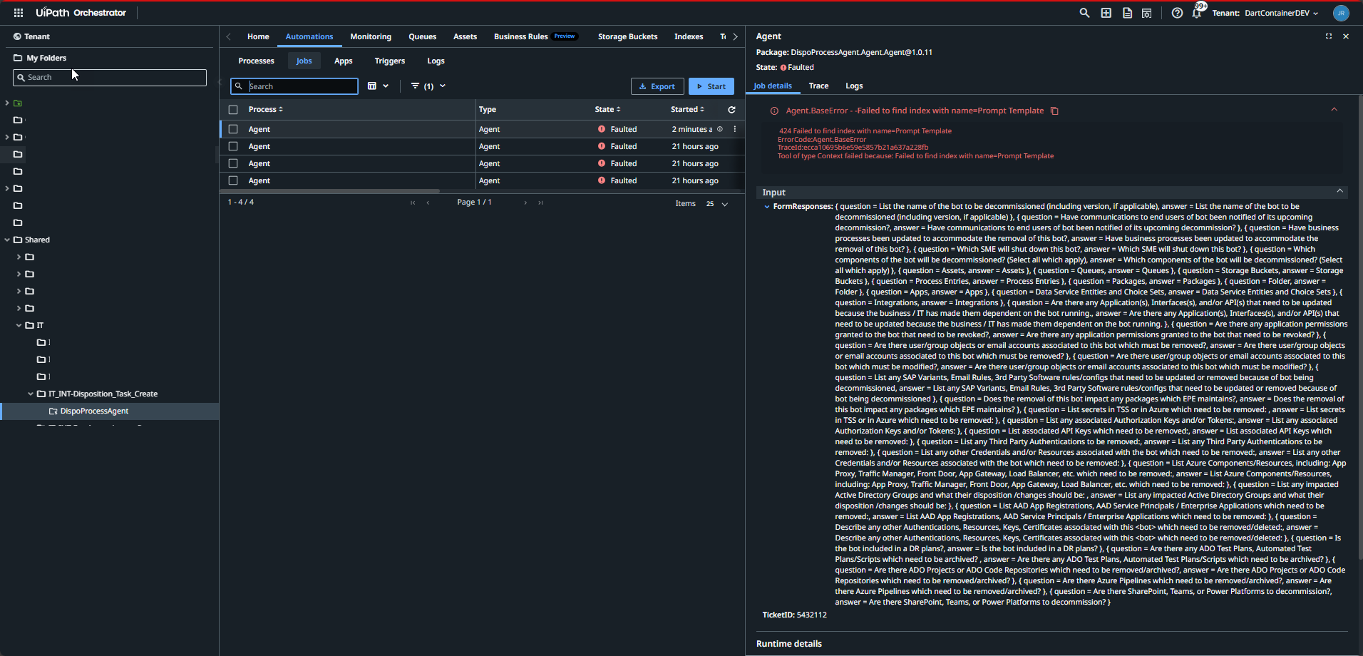

I’m trying to deploy an agent to do an end-to-end test on the process(taking a form response for disposing of an asset and creating tasks for the relevant teams).
I can sometimes get it to run in test on Studio but if I try to call it from other code or deploy it, I have only gotten it to work once. Otherwise it throws:
424 Failed to find index with name=Prompt Template
ErrorCode:Agent.BaseError
TraceId:2fcfe875a1aadd90883a44b3735b66ea
Tool of type Context failed because: Failed to find index with name=Prompt Template

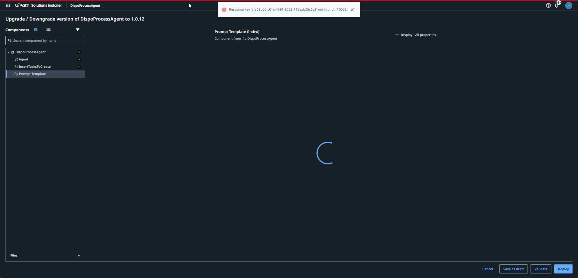

  1. Sometimes when attempting a deployment I get the below error and it hangs permanently. I have to publish a new version, nothing else will fix it.

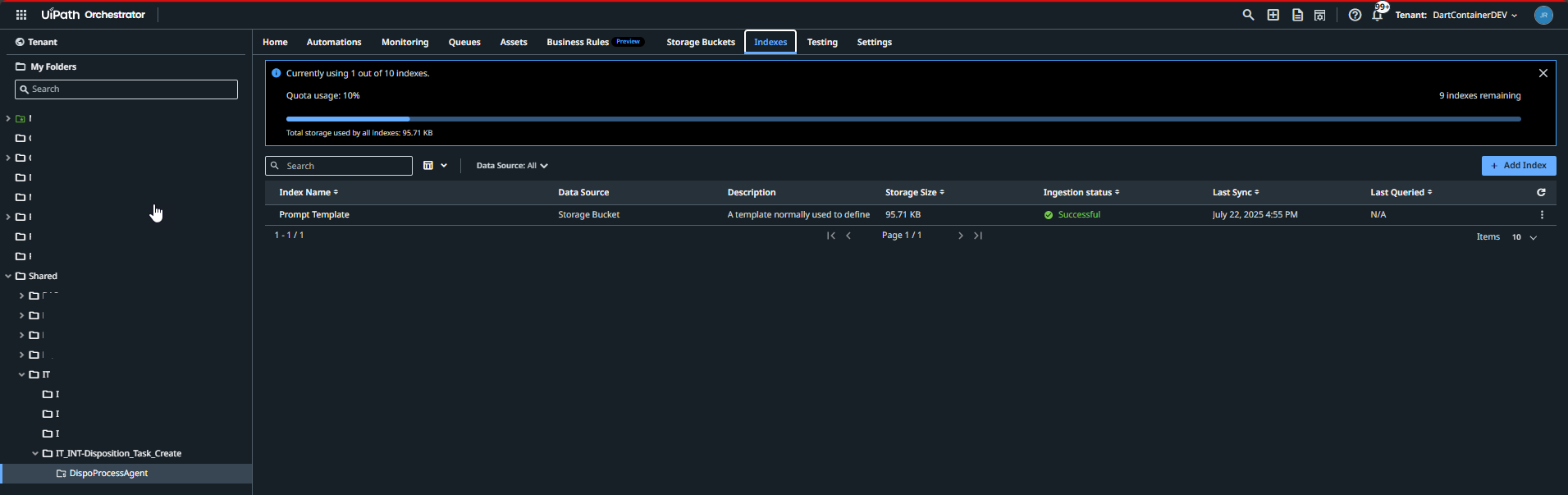

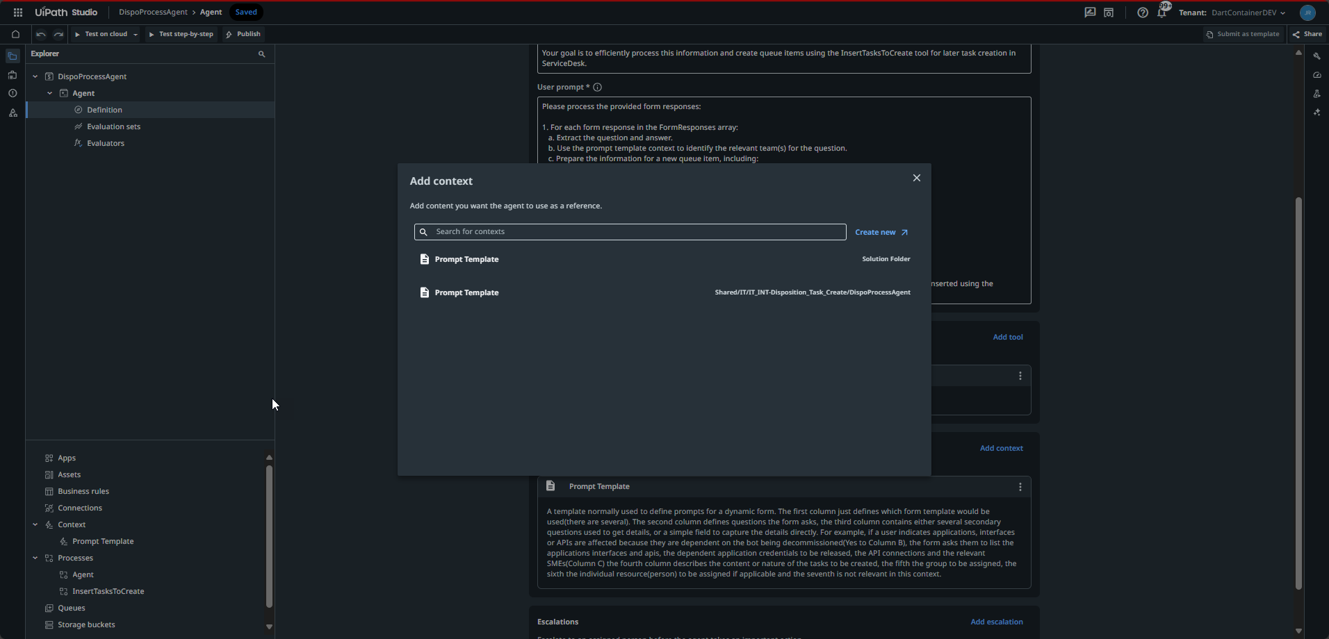

  1. View of the index list for the folder
View of the process sitting in the folder(note the unknown status for the index in the same folder)
View of the agent definition and the window showing both that the folder does have it and also that the index is found in the location from the Agent Builder

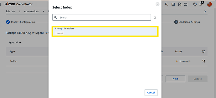

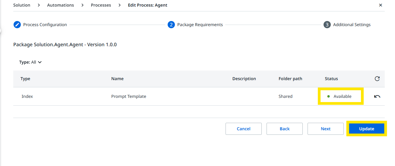

Hi @Joshua_Rowlison

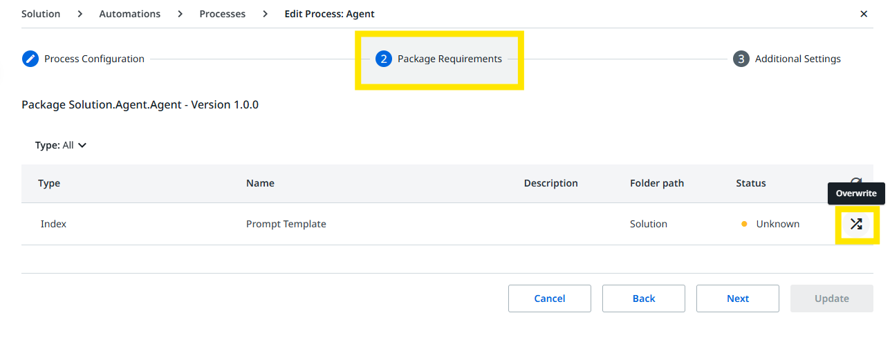

I tried replicating your issue, It shows “Unknown” Status:
In my case, I used index from a different folder. There is no index in the Solution Folder
Please try the following Solution:

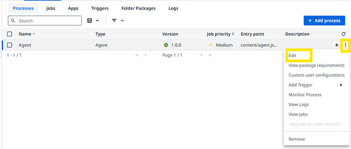

  1. Go to “Edit” option of the Agent
  2. Then, Go to “Package Requirements” → “Overwrite”

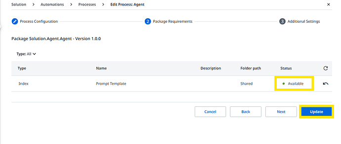

  1. Click on the Index that you really want the Agent to map to.
  2. The status MUST CHANGE to Available. Then click “Update”
Please run the Deployed Agent again, and let me know.
If this solves your issue, Do mark it as a solution.
Happy Automation :star_struck:
Hello, thanks for the advice, I was able to alter the process to overwrite the index and change it to available. It seems the first deployment probably rolled out the index in the solution and then subsequent deployments see the change to use that copy but the process itself never gets updated. Or something in that area.
