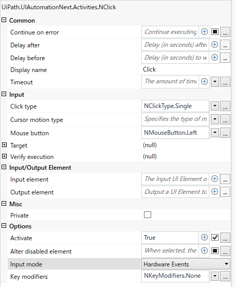

  1. Click on the Project setting → Ui Automation Modern
    In that check on the time out
For now, can you try to change input mode to except Simulate (such as Hardware Event) in Click activity which is for showing Dialog?
Or it might be also good to use Parallel and Click which is for showing Dialog?
In any UI Based activity the default timeout is 30 seconds
You can change the property in TIMEOUT field of that specific activity to any seconds you want
If you want to change the default timeout for all the Ui based activities in your workflow then you can change as suggested above with project setting
Hope this clarifies
Cheers @ivan4
Thank you very much for the guidance. Let me try it out and revert back. Cheers
Changing the timeout from 30 secs to 2 secs in the UI Automation Modern worked for me.
