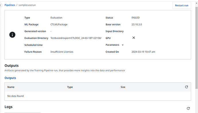

When ever i try to create the Pipeline is getting failed in Ai center?
Actually we are using the Folder for the dataset but i don’t why its getting failed immediately after i create pipeline previously is runed good but not now.

No we are following same steps even though its failing
@naveen5
Can you share the screenshot of the failure and the reason for the failure those will be available in the pipeline section in your orchestrator please check and share those and it might help to understand the issue.
Regards
pipeline_report_1ce58f16-53f8-4343-9006-f3d60737e648.txt (1.9 KB)

Hi @naveen5
It says Insufficient Licenses.
Basic Understanding can be cleared out using the below example.
Assuming you have two AI units.
For each skill deployed it takes 0.5 license units, and consumes 1 license unit for training.
So there should be only 2 ML Skills Deployed and lets say if you have more than you can stop them for sometime and start the pipeline.
If there are 4 pipelines deployed,
that means your 2 licenses are in use, thus you need to stop 2 of them and start training. later once the pipeline runs, resume the 2 that you stopped.
Later when the pipeline completes, Resume the ML skill again.
