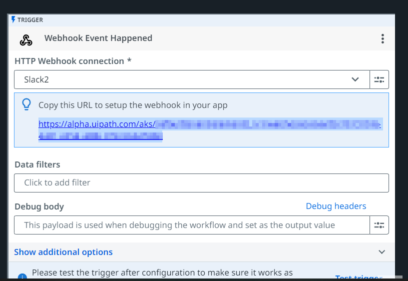

I found a link that would work perfectly for what I want to do, but it’s for Slack, and I want to use it for another app.

One work around for you is open a cross platform project in studio then you can find the webhook connector..search webhook in activities and you would see it

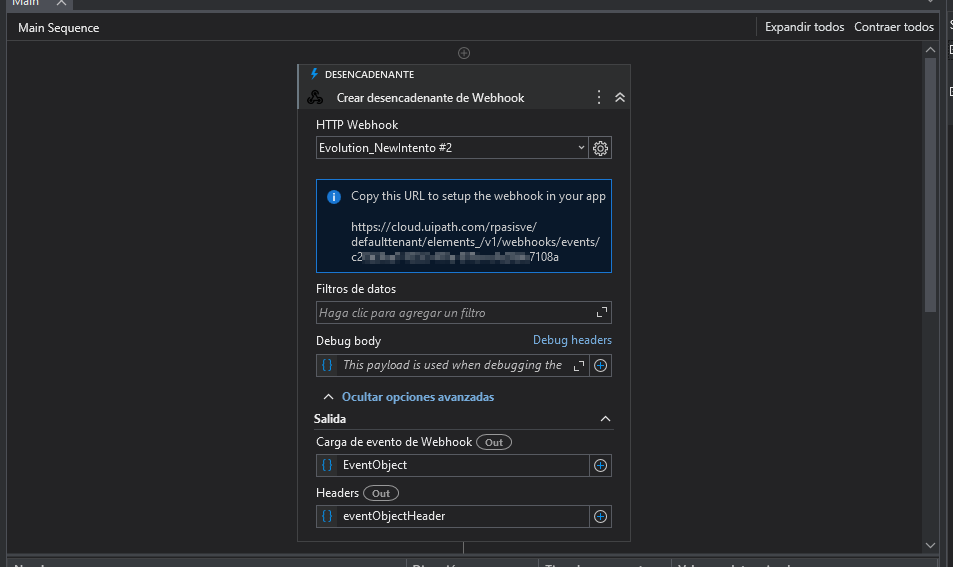

I’ve seen it in Studio, but I’m not really sure how it works — whether it runs directly from Studio or if I have to publish it to Orchestrator. Also, I don’t understand why the URL provided by this activity is different from the one I got when I created the connector (as @ashokkarale mentioned above).
@Matias_Clemente.Arg
In studio if you need to test then you need to fill the debug body its like you giving the body here itself
Once you publish to orchestrator and create a process ..then you can see/create an event trigger ..the url you see in orch is what you can use..
Also till you publish and create a trigger ideally you would not see a url in the connector as far as I remember

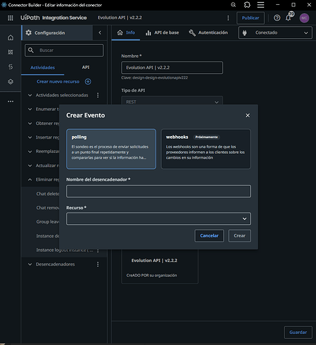

When I tested this with the “Connector Builder” and followed guidance through ChatGPT, it indicated that I needed to create a trigger. The trigger I need to create is of type “POST”; however, it seems to be disabled. Is this the case? Someone in the forum mentioned that sometimes this can be “requested” to be enabled for us. Is that correct?

If you want to use webhook you need not come to connection builder again as the webhook connection is already created
Once you publish..go to triggers → events triggers → create and select the process and yhe connector

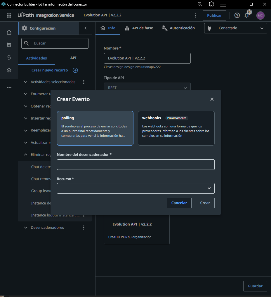

When I attempt to create a trigger within the creation or configuration of my custom connector, two options appear: “Polling” and “Webhook.” I interpret that to recreate the activity “Webhook Event Happened,” I need the one labeled “Webhook.” However, it does not allow me to select it; it is simply grayed out and cannot be chosen (beside it, it says “Coming Soon” in Spanish).

Webhook event happened activity is for external application to send an event
Webhook trigger or polling in custom connector is for you to identify the event that hppended outside without the other system sending it..

Then you can just create a webhook connector ..get url and use the url in the webhook of watsapp
There is no need to create a webhook in the custom connector
