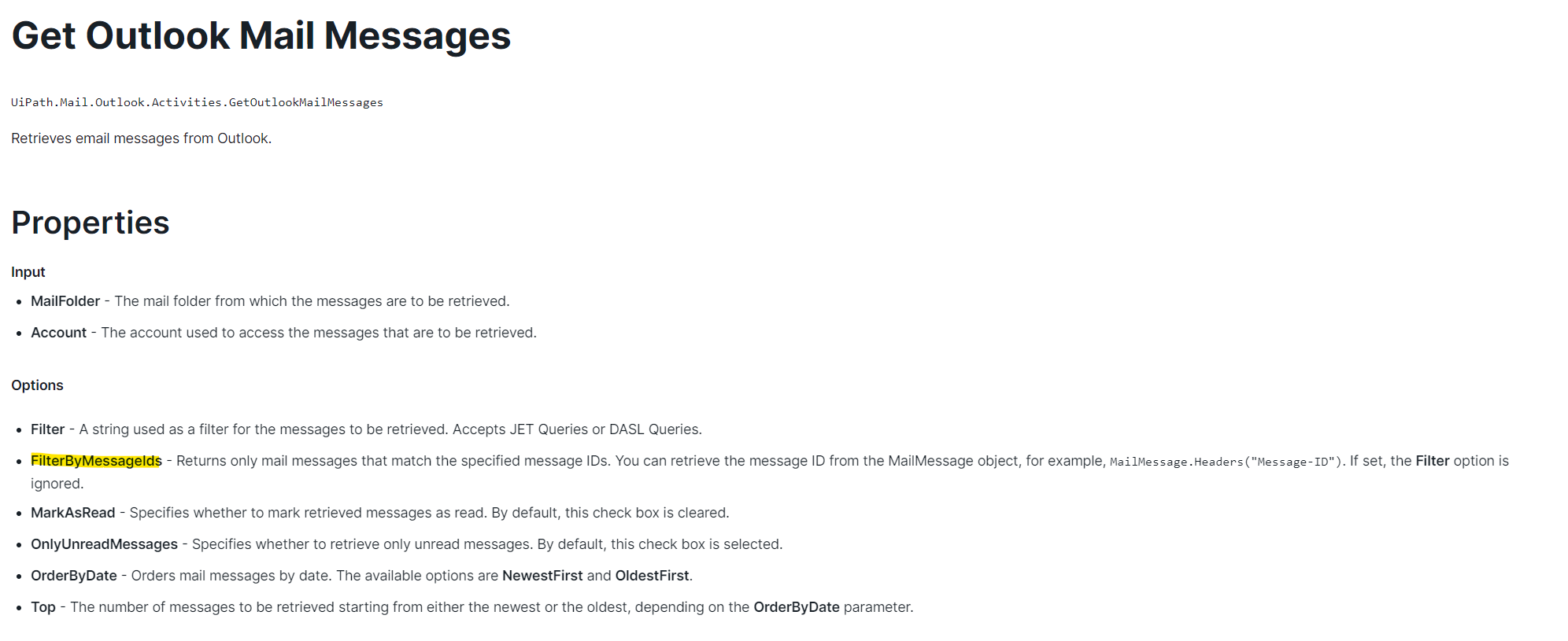

I have a string value (i.e. the message ID) and I need to be able to use this in the Filter property of the Get Outlook Mail Message activity.
How do I do it?

Can you try using “FilterByMessageIds”? If you can’t see the option, please update Mail activity package version.
Activities - Get Outlook Mail Messages - https://docs.uipath.com/
Instead of Filter you can choose FilterByMessageIds, and you can pass your message ID as a String

I have already tried that - entered the string to the FilterByMessageIds but I got an error: “Value of String cannot be converted to String()”

It’s expecting an array. If you have just one value, create first a new String array containing the value, and pass that instead ![]()
