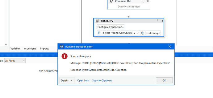

@mkankatala this is error I’m getting. If I Run only Select * from [Query$] it’s working
Hi @ch460960
Check the below thread
Or try this:
SELECT * FROM [Query$A6:Z100000] WHERE [PEACCM] = 12 AND [PEACCD] = 31
Hope it helps!!
Thank you so much :slight_smile:
