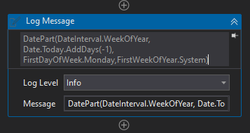

Hi @peterlimonade,
This should work for you: (I am here assuming your first week day is a Monday)
DatePart(DateInterval.WeekOfYear, Date.Today.AddDays(-1), FirstDayOfWeek.Monday,FirstWeekOfYear.System)
This returns the week number.

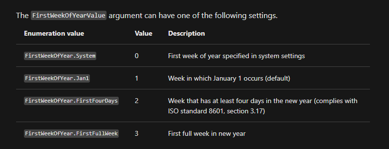

It might be because we use FirstWeekOfYear.System
You could try this?
FirstWeekOfyear.Jan1 and others. Since I do not know your entire date data I cannot recreate that issue.
Reference: DateAndTime.DatePart Method (Microsoft.VisualBasic) | Microsoft Docs

Thanks, u answered my question! Right now i am using FirstWeekOfYear.FirstFullWeek with this code uipath starts with the first week on 4 january. Thank you for your help!
