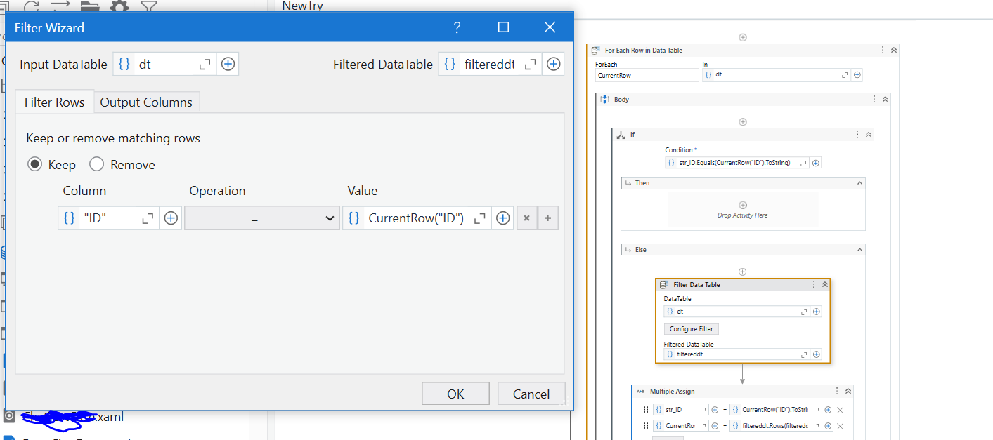

Try this
Create avariable str_id and initialize with string.Empty
  1. Use for each row in datatable on the data read from excel say dt
  2. Inside the loop use if condition with str_id.Equals(currentRow("ID").ToString)
  3. On the then side do nothing
  4. On else side use assign with str_id = currentRow("ID").ToString
  5. On the else side after assign use filter datatable actovity and filter dt and output can be filtereddt…and filter "ID" equals currentRow("ID").ToString
  6. Use another assign after filter with currentRow("1-DD").ToString = filtereddt.Rows(filtereddt.Rowcount-1)("1-DD").ToString
This will ensure every first new row is replaced with last row

This is how it looks

But shy getting this error
@Garyy
Please check in the multiple assign if filtereddt.Rowcount-1 is given or not
cheers

Please check this
this is how the second for is to be used
NewTry.xaml (18.4 KB)
