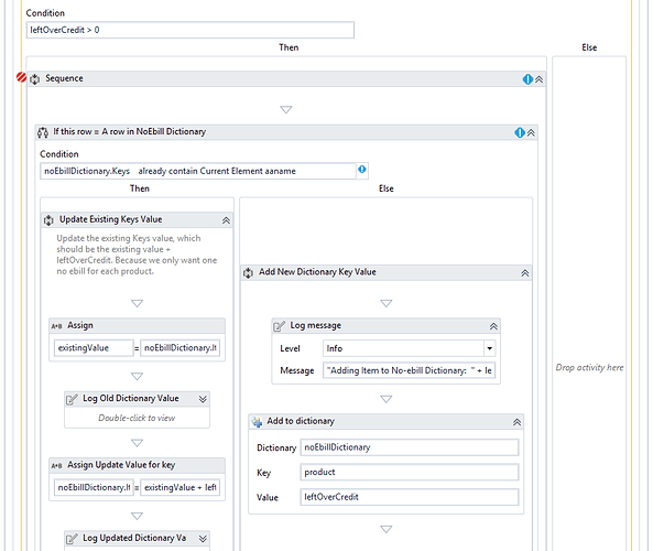

This is what I have right now. This is just the part I’m working on. There’s a ton more above this, but this is inside of a few for each loops. It’s looping through the row labels, and the row prices, and if they are on the same row, it applies and calculates a credit for each row, if there isn’t enough Money left to credit, it adds that amount to my noEbillDictionary, which means, We’re saving this amount to apply the credit in a different way. Like when your internet and phone are out of service. Credits for time out of service. We can only credit what’s available on the e-bill, after that if more credit is required it goes through the no-ebill process. So I need to save the product name, and the amount for later use. Still thinking about if I want to use the aaname. It certainly does seem easier.
I don’t completely understand your screenshot, but looks like product is your key.
So, the condition can be like:
noEbillDictionary.Keys.Contains(product)
Then, assign the existingValue + leftOverCredit to that key, like you were doing.
I’m assuming product is an element so it should already contain the aaname as the product that you are wanting to change. However, I don’t know how you are setting that element variable because it is above your screenshot.
Let’s say you use a Find Element activity, then you can identify the element using the aaname string. This will store the element to an UiElement variable that contains the aaname, so there’s no need to look for the aaname in the element after you have stored it to the variable… if that makes sense.
If you choose to use the aaname the key, the only difference will be that you won’t need to use an UiElement variable, and instead would use a Selector string to identify the element.
EDIT: correction to condition.
Regards.
I’m in the process of converting all of the Dictionary activities to handle the <string, Double> Instead of using the Uielement. I’m hoping it will work.
