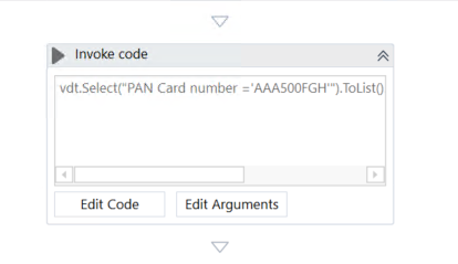

I am trying to select rows from a datatable and update a particular value in the selected rows.
Since it is updation therefore we cannot use an assign.
Hence, I used an ‘Invoke Code’.
Please find the snaps of the code inside Invoke Code.
Though the vb.net code doesn’t show any error, while running the same I get the error as
“Exception has been thrown by the target of an invocation”.
I guess there is a problem with the action done in the ForEach method in your expression.

You code seems synthatically correct so I imagine the issue is elsewhere.
Are you sure that the first part (.Select) returns any row? that the column names are correct and the State datatype is a string, that Pan card number is a string as well?
A trick you can use, to get the proper exception message from the invoke code is to refer to its “inner exception”.

This C# code is erring at “delegate” while I use it in ‘Invoke Code’.
Can you please help?
