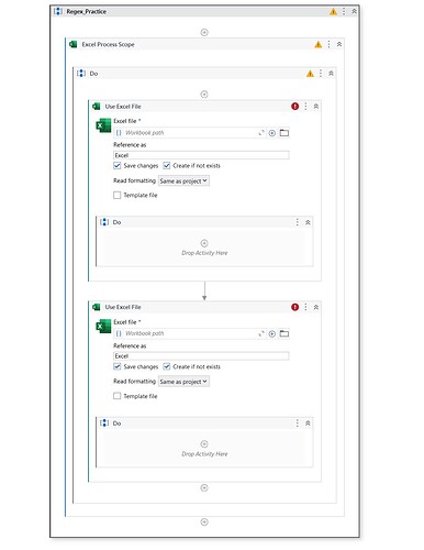

It should work fine as long as you don’t have one Use Excel File inside another Use Excel File. If you need to nest them, just change the Reference variable.

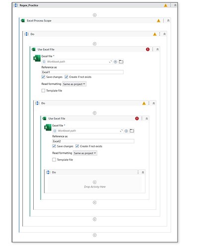

No it’s not possible to use the same reference variable for the multiple Use excel file activities, if one use excel file is used inside other use excel file activity.
Change the reference name for each use excel file like Excel1, Excel2, Excel3 like that.

In the below case it works with same reference means using Use excel file in a sequence,
In the below case it will not work with same reference means using the Use excel file inside another Use excel file,
