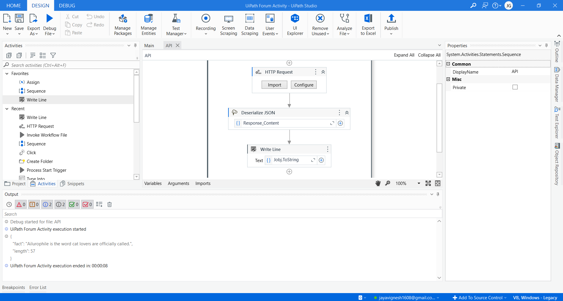

Hi @adext,
I can able to access/get data through API Call from the below Site,
Site - https://catfact.ninja/fact
Reference - https://youtu.be/c2Xgv1-2jfg
Hope this will be helpful. Happy Learning !!
Thanks in advance,
Jayavignesh G
