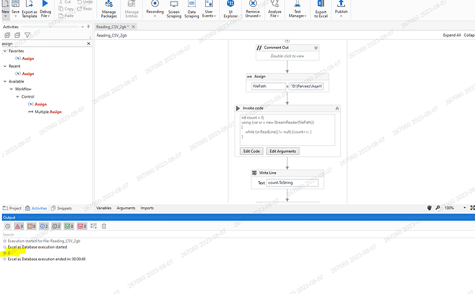

I tried the above approach , and im getting the count 0.
can you please correct me with this code, if it works.

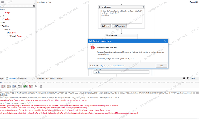

@ppr Tq so much its working , im able to get read the data , but later im trying to pass that string to generate data table so that i can get a datatable, but im getting the below error

Dear @ppr @supermanPunch
I tried using the Code the bot is able to read for lesser data but the bot is not able to read the file for huge data, please find the below screenshot
