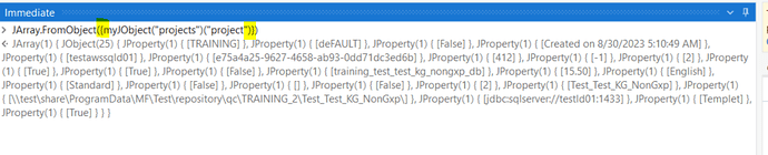

We could do like this:
grafik
output - myJObject
then we can create JArray by:
JArray.FromObject({myJObject("projects")("project")})

we could do directly:
grafik
Can iterate dynamically over all Properties:
