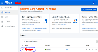

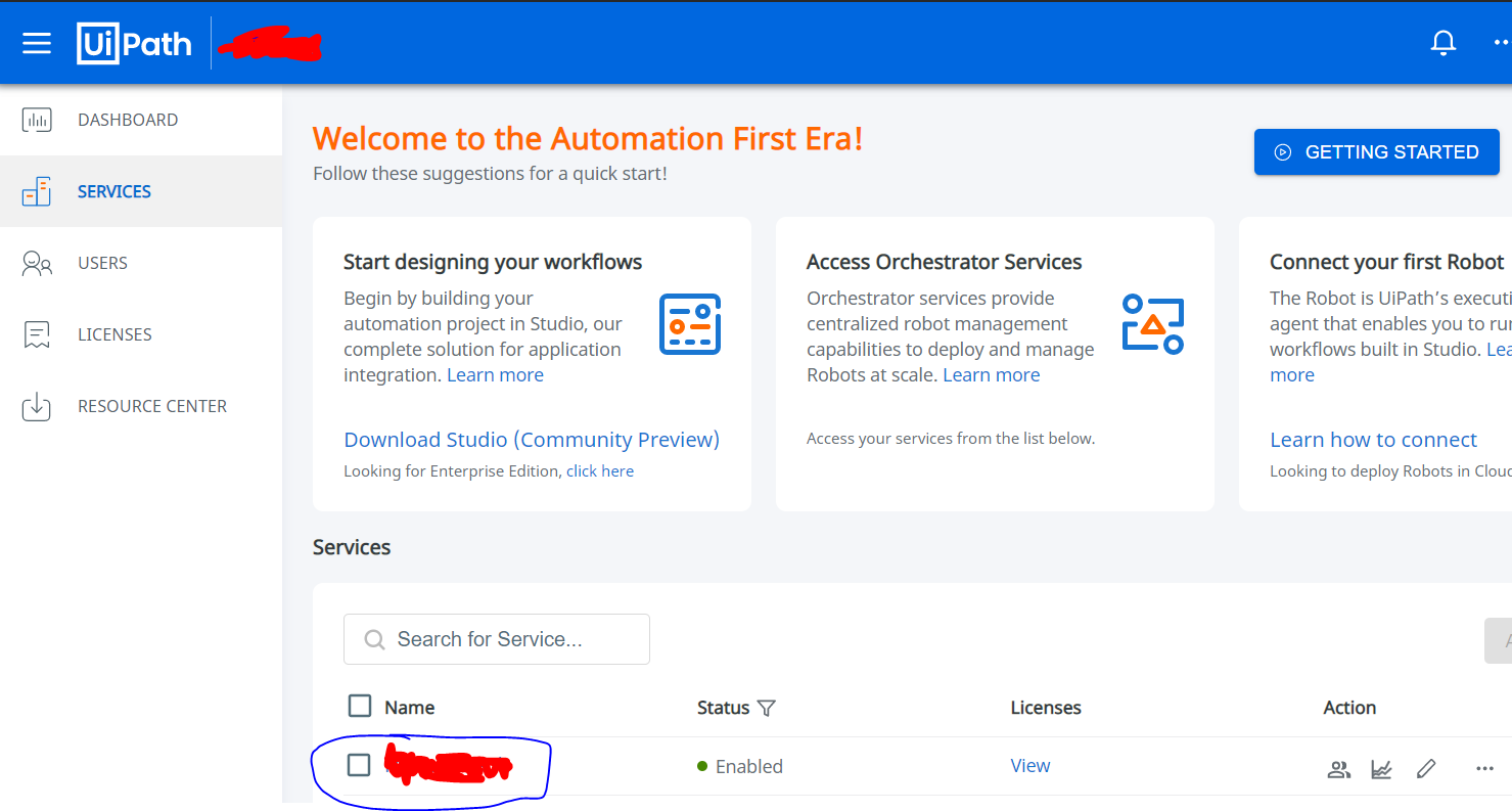

So, in the first page of orchestrator you should see this:
Make sure to click on you tenancy, circuled in blue. This will open another page that is your orchestrator page, like this one:
Use the URL from the last image, that should be something like UiPath(circuled in blue)/api/Account/Authenticate
