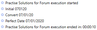

Hi @emm
Below is the workflow which gives your output
looksLikeDate.xaml (5.3 KB)
Output as below :-
Hope this workflow may help you to solve your query
