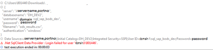

yea, that’s what I’m after now. Tricky but that’s a requirement. pls see the screenshot below…
If I dont use the “Integrated Security=True”, then it really tries using the other user, but still it doesn’t goes through as shown below,
really appreciate if someone could share thier ideas/thoughts to resolve this…
