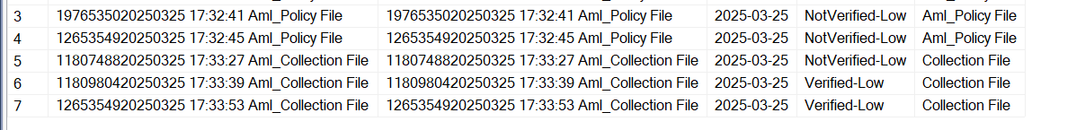

I would like to skip the duplicate records in the database because I occasionally receive duplicate records from the five separate excel files that I receive. I have attached the results from database..number 4&7 are duplicates from different files…Please assist…thank you

If you look at the screenshot there are no actual duplicate rows, the timestamps are different as are the last two columns for rows 4 and 7.

@pabaleloh
use like this..as I see onlu the number before time stamp is common
dt.AsEnumerable.GroupBy(function(x) x(0).ToString.Trim.Split(" "c).First).Select(function(x) x.First).CopyToDataTable
cheers
Which one you want to retain 4 or 7 ? Because the other columns have different values. Is that okay to loose those values ?
