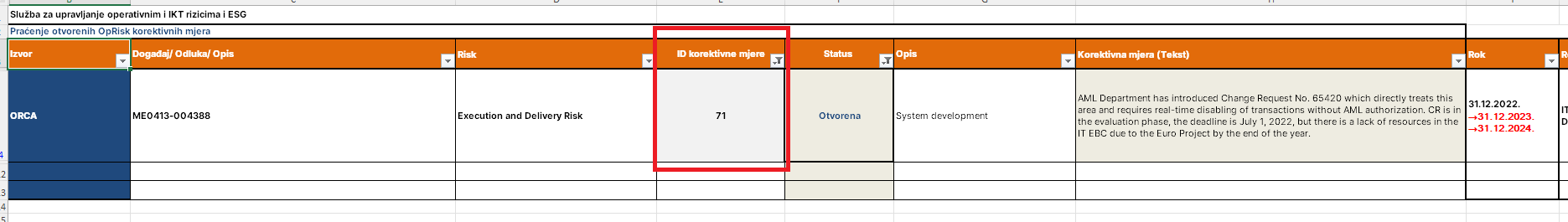

I have some excel file in which I have to set filter on one column and then to disable all filters (including that one).
I’m trying to prevent users from changing other filters and to see other data except the row I should filter dinamicly.

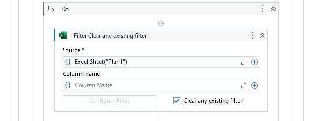

You can use the modern excel Filter activity in enable the Clear any existing filter

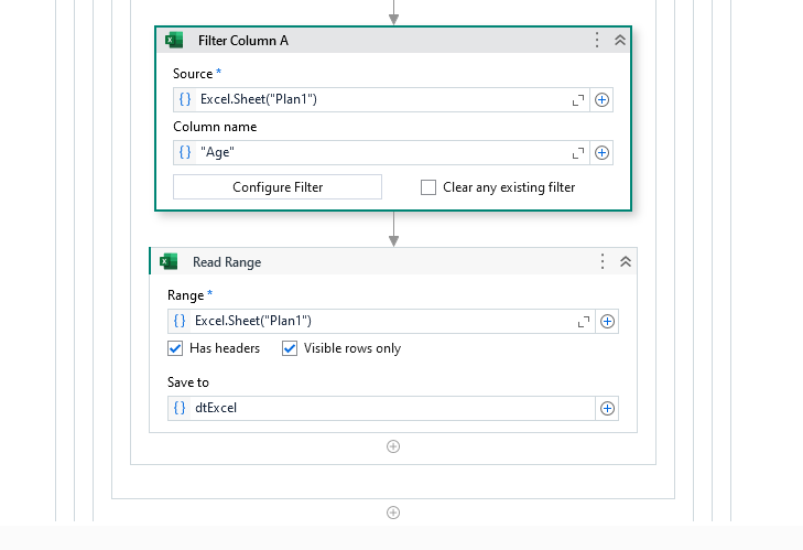

In same Filter activity you can try to Filter
Disable the Clear any existing Filter

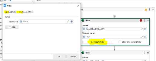

Then Mention column name which column you want to filter, then Click the Configure Filter in this window you can mention your scenario
After filtering you can use the disable filters activity

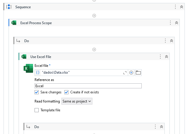

Step 1:
Step 2:
The image shows an Excel automation setup for filtering data, specifically configured to clear any existing filter on "Plan1". (Captioned by AI)
