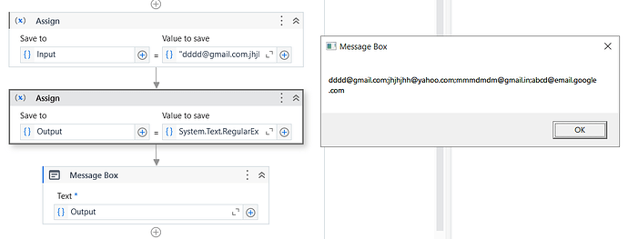

mkankatala
(Mahesh Kankatala)
July 29, 2024, 1:21pm
5
Hi @RPA_Dev13
Use the Regular expressions to replace the dot between the emails,
- Assign -> Input = "dddd@gmail.com.jhjhjhh@yahoo.com.mmmdmdm@gmail.in.abcd@email.google.com"
- Assign -> Output = System.Text.RegularExpressions.Regex.Replace(Input.ToString, "(?<=\.com|\.in)\.", ";")
Check the below workflow for better understanding,
Hope it helps!!

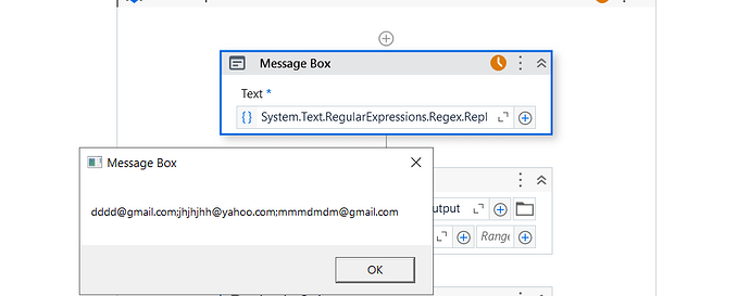

RPA_Dev13
(RPA_Dev13)
July 29, 2024, 1:25pm
6
Thanks, I tested this but not all the times the emails end with .com
also come like this
e.g., (dddd@gmail.com.jhjhjhh@yahoo.ie.mmmdmdm@gmail.gr)

mkankatala
(Mahesh Kankatala)
July 29, 2024, 1:42pm
11
Okay @RPA_Dev13
Try this one and let me know weather it working for all emails or not,
- Assign -> Output = System.Text.RegularExpressions.Regex.Replace(Input.ToString, "(?<=\@.*[?:\.][a-z]+)\.(?=[A-Za-z0-9\_\-]+\@)", ";")
Check the below image,
Hope it helps!!

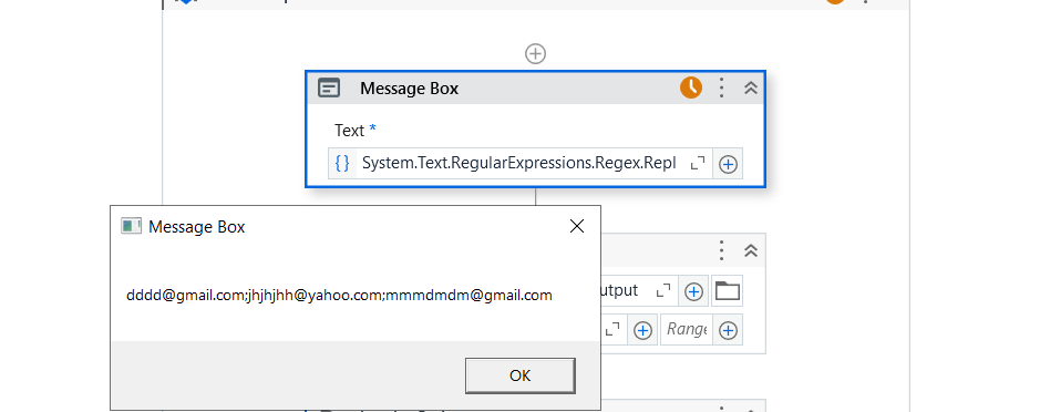

mkankatala
(Mahesh Kankatala)
July 29, 2024, 1:51pm
13
Try this one… @RPA_Dev13
- Assign -> Output = System.Text.RegularExpressions.Regex.Replace(Input.ToString, "(?<=\@.*[?:\.][a-z]+)\.(?=[A-Za-z0-9_\-]+\@)", ";")
I have changed the expression check now it’s working fine,
Hope you understand!!
RPA_Dev13
(RPA_Dev13)
July 29, 2024, 1:57pm
14
Working perfect, thanks everyone
