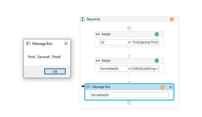

I have made one workflow for the same :-
MainPratik.xaml (6.9 KB)
See the output :-
CHR(34).toString+str.Replace(",",""",""")+CHR(34).toString

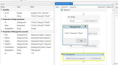

Hi @TyraS
I did the same what you said. I am not getting any backslashes
Output :-
Workflow for the same :-
MainPratik.xaml (7.4 KB)

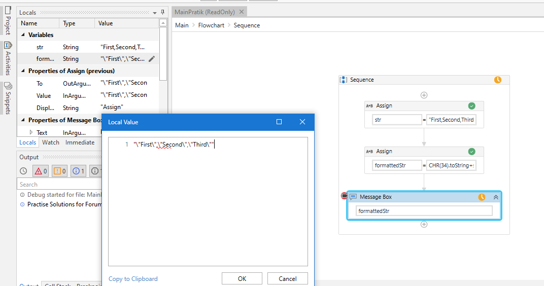

Hi @Pratik_Wavhal @Dave , It doesnt show the backslahes on the message box, but shows on the debugging panel. Hence when i insert the output string into another string, it doesnt work
Hi @TyraS
So you mean to say like the below SS :-
But further what process are you doing on that output value in which you are getting difficulty ??
And what difficulty or Error or the thing that is not working for u bcz of those slashes ??

A backslash is never used at any point in the code. Try using a write text activity and saving it to a .txt file. Does it still have backslashes? It may just be a visual issue when you’re looking at it in debug mode

Yup!
I see. It does not appear in text file.
