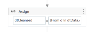

Also have a look at this modified LINQ
dtCleansed =
(From d in dtData.AsEnumerable()
Group d by k1=d("Name").toString.Trim, k2=d("Subject").toString.Trim into grp=Group
Let cntsCompleted = grp.Any(Function (c) c("Result").ToString.ToUpper.Contains("COMPLETED"))
Where not cntsCompleted
From g in grp
Select r = g).CopyToDataTable
Just let us know, where the result from given LINQ is different from the expected output.

input:
grafik
Flow
grafik
Output:
grafik
So,
