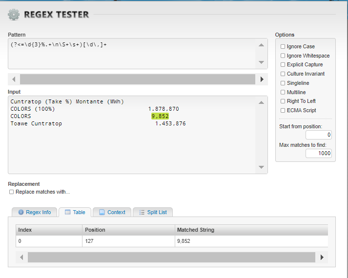

Hey guys,
Can someone help me
Capture the highlighted number,
with the percentage in the top row being the default reference
Cuntratop (Take %) Montante (MWh)
COLORS (100%)                           1.878,870
COLORS                                   9,852
Toawe Cuntratop                           1.453,876
Percentage that must always be in 3 digits
Because the second line below will only appear if the percentage has 3 digits
What you mean by this? You mean when percentage is 100% or greater …9852 or any numbers will appear …is it right?
if my assumption is right…Please try this…
(?<=\d{3}%.+\n\S+\s+)[\d\,]+
OR
(?<=\d{3}%.+\n.+\s+)[\d\,]+
Hope this helps…
that was it!!
Thank you very much!!
