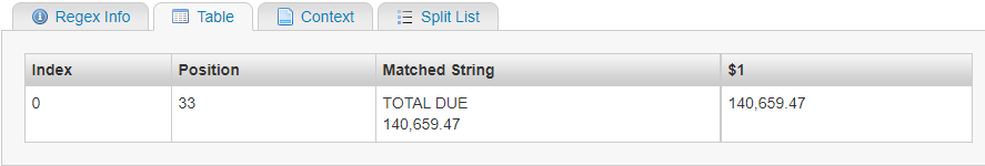

I would suggest trying to build regex patterns using a tester. I have found this one to be helpful because it actually has the .net language: .NET Regex Tester - Regex Storm
Just putting something together really quickly, I came up with: TOTAL DUE\r\n([\d,\.]+)
Here’s how it looks:

Thanks for the reply…But I’m getting result as
TOTAL DUE
140,659.47
But the output I need is
140,659.47
Could you please suggest on this?
Thanks again
Are you using the match group?
You have to pull out the portion that was captured. If you just look at the match text, it will give you the whole match like you’re showing.
