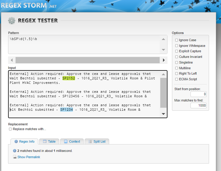

Hi @Chris_Bolin - Please check the below pattern…Since you specified more than 7 should be excluded i have added \d{1,5} if this is not your requirement adjust it accordingly…
Hope this helps…
This is great…I didn’t even think of using a word boundary - sometimes I overthink and miss the simple. Thanks so much.
