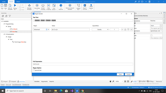

hi @indie9876
use regex pattern like this
then use for each actvity to iterate through each value
