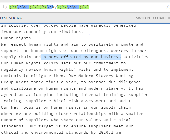

Hi @lakshman
I am facing issue in regex.
If yoy see the last line in Test string it is also having “By” word but its not highlighting word which are present before and after that.
Can you help me. I guess because of . its creating problem
I need such regex which can accept anyvalue (number,word,special character) after and before “by”
Hi @lakshman,
Could you pls help me out on above issue
@sshitol
First replace dot . with nothing and then apply regular expression to fetch required data.
yourString = yourString.Replace(“.”,“”)
Hi @lakshman,
Actually i need to use this regex on pdf which containing price. In this case if i replace . by “” then price of actual product will get change.
Is it possible to do something in regex which u shared earlier.
Because this issue was happening for all special character not only for .
