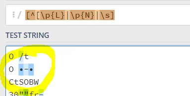

Pattern [~#%&*{}/:<>?|"-] will not get sth like this:
With this one [ those dots are also considered as thing to replace and letters with accents stays :
Thanks for help. @Adrian_Star nailed it
