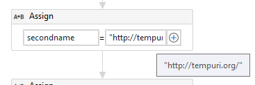

I do feel that a XPath Approach is better for the retrieval
Setting up a NamespaceManager with a Config Datatable:
[grafik]
for the default namespace with empty prefix “def” is assigne as prefix
the retrieval is configured as another datatable (could also be externalize into an excel)
[grafik]
I did also for a deeper nested element for demo purpose
After all preperation it is iterating over the retrieval config and retrieves the specfied values. et voila:
[grafik]
So this …

find starter help (show casing dedicated access and loop over the result element) here:
XMLDemo.xaml (6.7 KB)
in case of retrieval issues following trick helps to find out the needed things:
xDoc.Root.Descendants()(X).Name - play with X=index and find out the needed namespace for a particular element
really thanks for your support working fine
