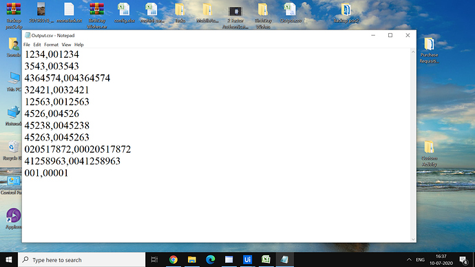

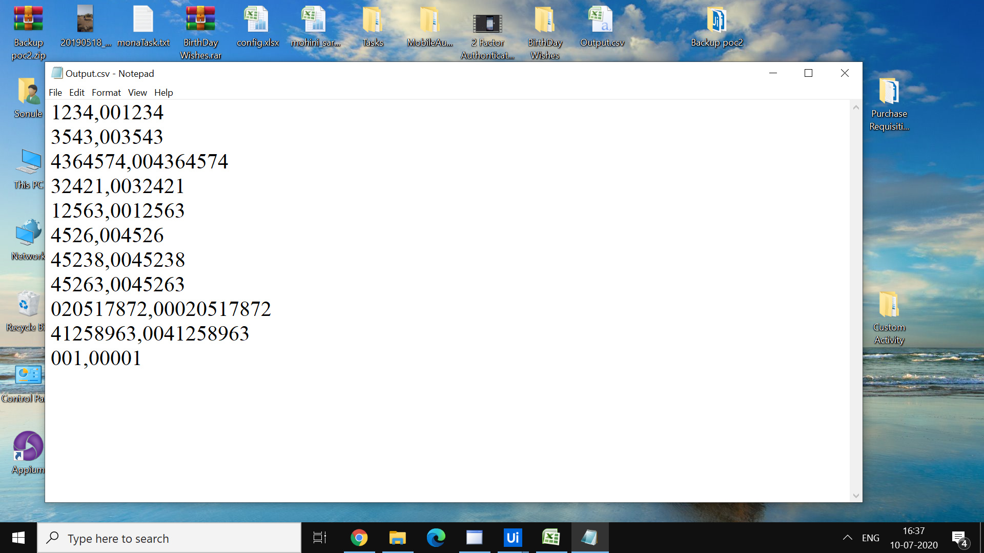

i wants to read csv with 00123 before number 2 zero … but it does not show zero directly shows 123 but in notepad it shows 00123 i want in csv 00123.
this how it looks but i want like this …

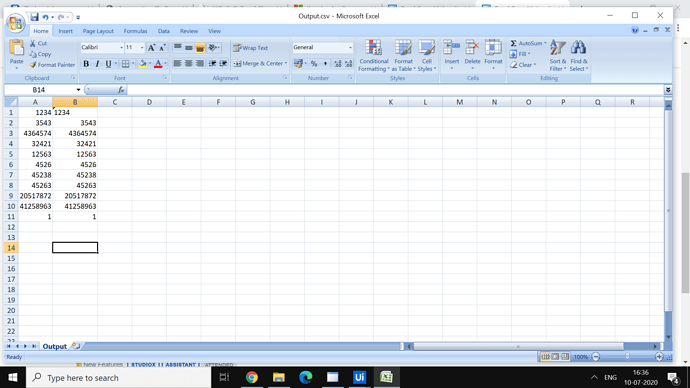

Hi @Mohini_Sarode
have you check the format for that cell within excel what is it ??
try making the column as custom format
may this helps you.

its working @Pratik_Wavhal but i want to do using uipath …

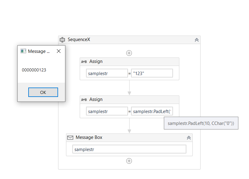

@Mohini_Sarode
Use PadLeft to add the 00
In your case - row(1).tostring.PadLeft(LengthoftotalNumber, CChar("0"))

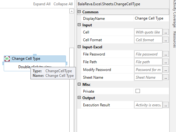

Hi @Mohini_Sarode
Der is one activity called as Change Cell Type by @balupad14
Try using that if it gives you the output

i m getting correct output but not seen in csv file …as shown above …

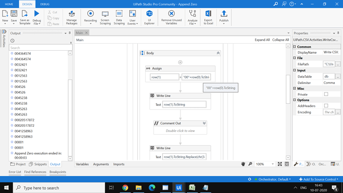

getZeroValData_csv.zip (16.7 KB)
Please find the attached workflow. I have taken 000123, 00234 as strings in input file.
Please try this, if you get any issues share the sample csv input file
I m getting Output but i am not able to see in CSV file …look up image …@Venugopal24

@ppr Hi Its show ssame like this i want like notepad …input 123 output 00123
