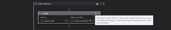

Could you help me with the print problem?
arquivosDoDiaAtual = Directory.GetFiles(diretorio, “-999”).Where(Function(x) New FileInfo(x).CreationTime.Date = DateTime.Now.Date).ToList()
Error ERRO Erro de Validação Não é possível atribuir do tipo ‘System.Collections.Generic.List`1[System.String]’ para o tipo ‘System.String’ na atividade Assign ‘Assign’. Main.xaml
Hi @amanda.gondim
Create a variable with List of String Datatype and give the below expression,
- Assign -> List_Files = Directory.GetFiles(diretorio, "*-999*").Where(Function(x) New FileInfo(x).CreationTime.Date = DateTime.Now.Date).ToList()
Hope it helps!!
Hello!
I still have this error now
I was putting the wrong type, now it’s gone, thank you
First type System.Collections.Generic.List in the search bar.
Then select the String from the dropdown,
I hope you find the solution for your query, Make make my post as solution to close the loop…
