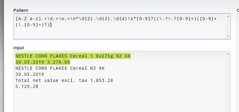

Hi @charith_wickramasing,
Try using this regex,
Thanks a lot, I’ll check and let you know.
HI @Gouda_6,
its working fine, do you know how to extract the values of Description, Quantity, unit delivery date & time and *net value separately?

@charith_wickramasing Can you mark which all values can extracted? If i extract values from this string also, will format be same across all other strings you get?
