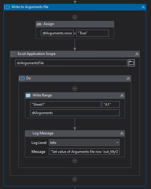

Due to my need for an immediate solution, I did the following:
1- In Init > If first run, read local configuration file > Invoke InitAllSettings workflow, I have the automation create an Excel file for arguments to save. These values are the base values for arguments that reset where a system exception would clear them. I have this file name and location set as an asset in Orchestrator.
2- In Process Transaction, I copy that file in as a data table. Where I have designated a system exception to occur, I change the value of the “argument” I need to save. For me, I am using a boolean that will be needed in end process. Then I use Throw.
From this, where ever I need to take an action based on an argument that would normally clear, I have a file to read with the values that should have, but did not pass out.
Hope this helps.
