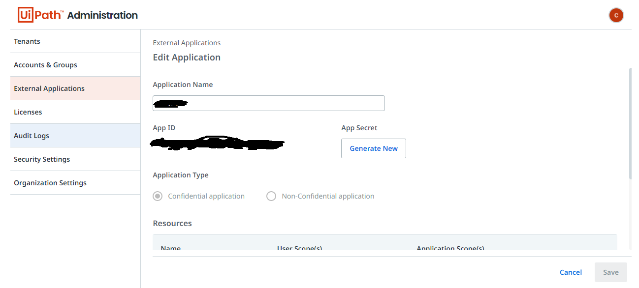

We set up an External Application connection in our cloud-based Orchestrator like this:
From that, we used the Orchestrator-generated App Id and App Secret to make a POST req, from the external application to the authorization Orchestrator API endpoing, to get an accessToken. This works as expected and we receive the accessToken back. Next, we’re trying to make a POST req, again from the external app to a different Orchestrator API endpoint this time, to add an item to a queue in our Orchestrator. In this POST req, we include the accessToken in the req (which we save into a variable called “bearerToken”) and followed the docs for the other headers and etc, but we’re getting this CORS error:
